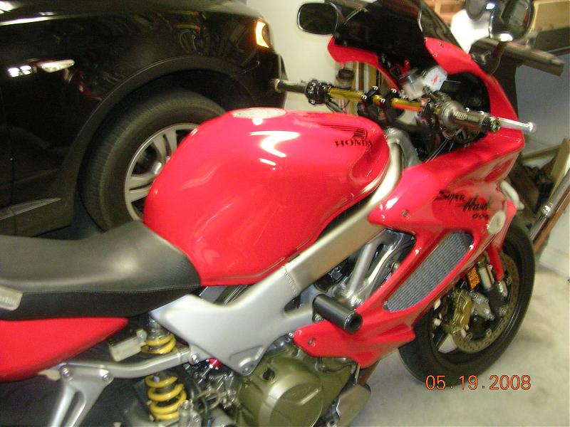

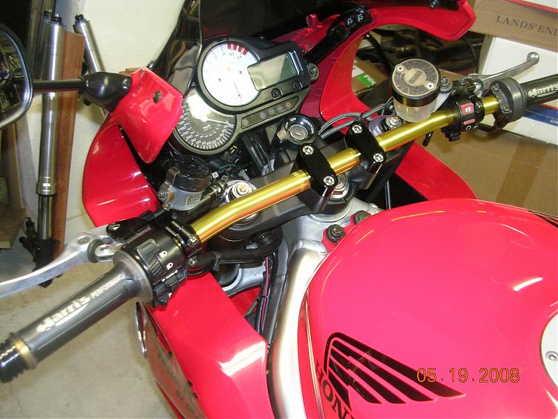

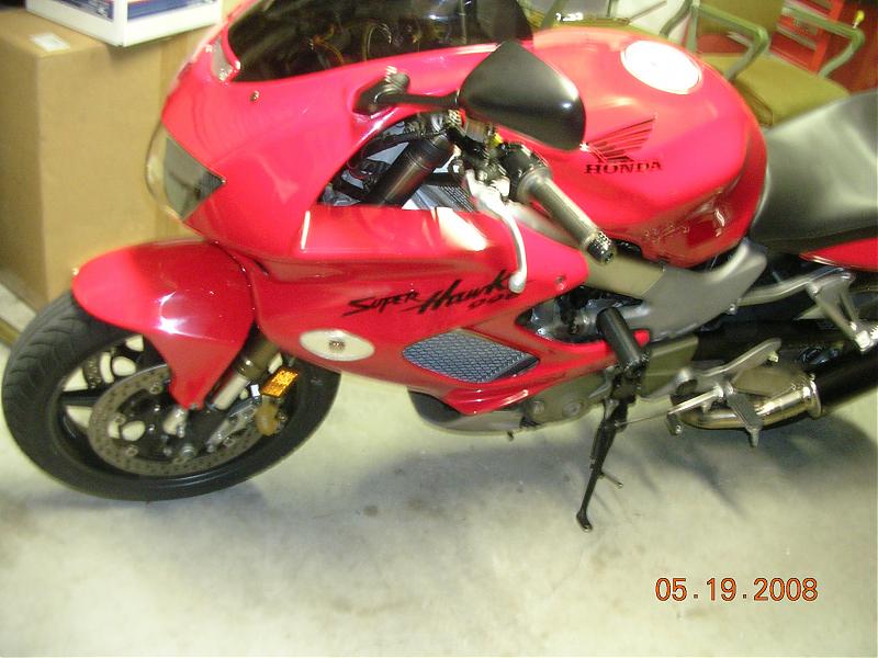

RC51 Front End Swap
Model year installed on 2002 VTR1000f
Fork legs SP-2 RC51
Lower triple clamp CBR954rr
Upper triple clamp CBR954rr
Superbike drag bar & risers (Thanks to Superbling's inspiration)
Steering stem bearings CBR954rr
Brake calipers SP-2 RC51
Brake rotors SP-1 RC51
Braided steel brake lines
Brake master cylinder stock for now
Front wheel SP-2 RC51 5 spokes
Front fender CBR954rr - red matches close enough
Installers Narrative

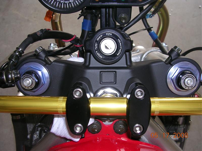

Steering stops from the CBR954rr lower triple have to be trimmed and if done right you can get steering locked.
Drilled the top triple to add Superbike bars on a drill press and came out nice...
The gull winged top top triple allow clipons above the triple, but I went with Superbars for now and have 2 lines showing on fork tubes above the triple and MCs both fit but tight.
Radiators needed to be repositioned to allow space for beefyer forks...installed 7mm spacers on front brackets to push rads out from frame and turned top conecting rad hose till it gave room for lower triple. You will get some hose pinch, but nothing that would cause problems even at steering lock...
I repositioned the horn on the steering stem and used the 954 horn cuz it's louder and sounds like a VW bus
1st impressions:
WOW
This is not the same bike! It wants to go fast all the time and the bumpy curves on my regular commute don't have bumps anymore There's so much more braking power I'll use 1 finger from now on and the forks have more adjustment (compression, Rebound, pre-load) then I'll ever need

This confirms my belief that there is enough room on the top of the gull wing triple to mount the TAG handlebar clamps, which really simplifies the bar mounting problem using that top triple. It won't satisfy the fussy guys who insist on using clip-ons, however. I'm not too sure about the drag bars, though. Is there any bend at all to that bar?
Now I see you have added another picture and there is a slight bend to the bar. I cut my superbike bend bar to the width of the stock clip-ons.

This confirms my belief that there is enough room on the top of the gull wing triple to mount the TAG handlebar clamps, which really simplifies the bar mounting problem using that top triple. I'm not too sure about the drag bars, though. Is there any bend at all to that bar?
Yes, it has a slight bend, bot not much...I just drilled the two circles out that are already on the back of the triple

i want to drill my 954 triple and do the motocross bar thing. i see a problem if i did it your way though. how can a scotts damper fit into that picture?

1st off you should consider why you currently have a steering damper and why you may not need it with superbike bars...
2nd depending on which fork tubes you are using and how you setup your rear shock there should be lots of extra fork tube to run up above the 954rr gull wing top triple...
The RC51 tubes are plenty long enough to run 954rr clip-on Heli bars above the triple cuz I've done it
